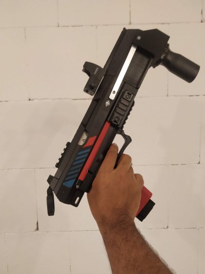

I will follow Joshi as (surprise surprise), I had worked on the blasters sent to him. :)
So I started with the raptor XS-908 blaster as it had decent foundation. It has decent performance (130 fps for its original spring and worker barrel, 150 FPS for 12 coils k25, and 6inch brass). Additionally, it should be compatible with mini talons (never could check, more on this later). I decided to convert this blaster into pump action prime from top prime as it is too chucky as a pistol but showed potential as a CQB-esque blaster. Accordingly, pulled out the good old vernier calipers and did the below EDs:
Unfortunately, I don't have the skill sets to get from concept to CAD to prototype. Reached out to @flatten_the_skyline, who was happy to help. Flatten designed the CAD files (attached here) and printed them for me. This was quite interesting as we had never worked together, he has not held or actually seen the blaster in person. Yet, it worked in one try. In fact, his design and print was so good that the extension just friction fit to the blaster.
After that, it was just a matter of finding extra long bolts and special nuts to secure the blaster and the barrel extension together, and adding on the pump bit.IMG_20221121_204851.jpgIMG_20221129_163738.jpg
Ater some trial and error, I decided to go with a smaller worker barrel and the original spring as it had a nice smooth prime while still having high enough (130s) FPS. @Joshi If you want to increase the performance, use a K25 along with a slightly longer barrel and you should get 180s or so. As stuch spring loads, it would recommend the pull and push handle at the back (instead or the pump action, think of it as an extra long hand cannon).
Here's some words from @flatten_the_skyline (whose help, advice and contribution was invaluable in realizing the concept):
"Not gonna lie I had my reservations. Never met @Avinash Shankar in person and I didn't even hear about that blaster. But the design seemed straightforward enough, communication was good and so I got going. The technical drawings were quite good, I added some chamfering and raised tolerances where I saw fit. I was kinda nervous but the parts I sent fit at the first try..."
Regarding the stringer, it is by Leedledynamics (https://www.etsy.com/listing/1341665457/lanka-string-powered-foam-dart-pistol) and printed by @smells like foam . Interesting story. So my original plan was to make the above blaster and provide two nightingale mags modified (a notch cut in them) to work with the above blaster. unfortunately, I waited too long to order them and by the time this was ready, blaster-time did not have them in stock and it would have taken too long for AKmods to ship them. Hence my plan to add the stringer (aka beauty, the above blaster becoming the beast). The stringer is compliant with talons as was my way of making up for not providing compatible mags.
Unfortunately, the stringer is kind of tricky to tune. To get decent FPS (90-100), you need to increase the tension on the elastic. However, then the elastic has a tendency of going above the dart in the chamber. (It is picky about old/bendy darts). I thought I had fixed the problem by using superglue to increase the material holding on the dart and by reducing the tension on the elastic (around 70 FPS). I did test it before sending with worker gen 2s. I am sorry for it not working.
All in all, I had fun in building these. Thanks to @flatten_the_skyline and @smells like foam for their help. @Joshi I hope you enjoy plinging and tinkering with them. Let me know if you have some ideas regarding the stringer.
PS: to my secret santa, damn you for introducing me to lever action blaster :p. Not only does the blaster you made look good but it feels pretty good to operate. I now see the appeal in lever action (especially priming with your dominant hand). Please know that if I end up buying a SLAB, it's bcoz you :p .

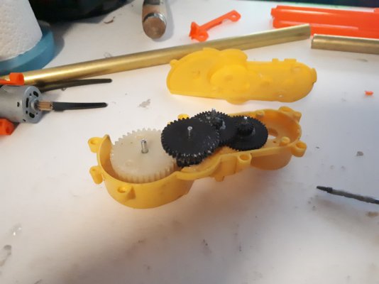

In deiner Stampede sind Metallzahnräder verbaut dass du gute und starke Internals verbauen kannst. Es befindet sich auch extra dafür angeschaffte Blasterparts Teile in deiner Stampede. Der Plunger wurde mit Epoxy extra an den wichtigsten Stellen verstärkt, der Plunger hat auch direkt Moosgummi padding bekommen.
Ich habe gesehen du hast eine menge performanter Blaster, dieses Jahr habe ich ihn nicht angemalt weil ich es dir überlassen möchte wie du diese wahrlich wunderbaren Blaster im Schlachtfeld nutzen möchstest. Vielleicht machst du eine Stam SMG draus.
Im akkufach befindet sich eine 11.1 V Lipo, ich denke mit deinen Ladegeräten sollte das auch gehen.
Ursprünglich sollte der Blaster auf langdarts getrimmt werden, leider habe ich das zeitnahe nicht mehr hinbekommen unzuverlässige Zuführung und so .. was nicht heißen soll das es so bleibt! Du kannst gern schauen ob du das hinbekommst, ich habe dir den breech akkurat genug gemacht ;)
Un zum technischen, der Killswitch rechts am Blaster ist zwar nicht im Stromkreis angeschlossen aber kann reaktiviert werden! Ich würde dir den roten switch empfehlen der dabei war.
Die stampede verschluckt sich ab und zu, es kann sein dass die noch bisschen gefettet werden muss, oder das eine stärkere Rückholfeder rein muss.. also quasie Stock Rückholfeder und eine halbe.
Ansonsten habe ich den so pur gelassen wie möglich, selbst das Akkufach könntest du reaktivieren um auf normale Batterien umzurüsten.

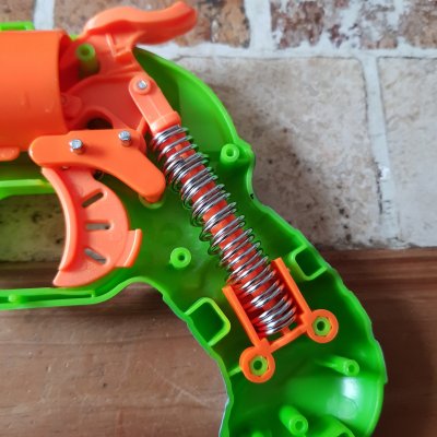

Dazu hab ich nochmals verschiedene Industriefedern getestet, das geht bei dem blaster ganz gut, zum Federn tauschen muss man nur den Schlitten mit den 4 Schrauben demontieren.
Da ich vor absenden noch einen Sonntag hatte hab ich nochmals Darts getestet und auch verschiedenen gekürzt.
Gab zum Blaster 2 kleine Kartons mit darts, einer mit Darts für den Larp, einer für ü18 Battles.
Bei Bedarf kann man ja noch ne schwächere feder einbauen, die ich leider nicht mitgeschickt habe, da ich dummerweise alle wieder in einen großen Haufen Federn gelegt habe.

@Avinash Shankar
For my first time i buy this
And for @NIGHTHUNTER79 Blaster i buy
PS: this was my second water transfer printing and i had to cover something with black paint 😅
Sry, the next Text i User Foogle Tranlator ^^
I worked according to the instructions from the starter set.
water in the container heated to 33 degrees, measured with a fever thermometer.
cut the film, then put it on the water for 90 seconds, then put the activator on it, waited 15 seconds, then held the part at an angle of 45 degrees and slowly immersed it.
after taking it out, rinse it carefully with warm water and let it dry. from cutting the foil until now worn disposable gloves.
Touched up after 24 hours with a bit of black paint, after another 24 hours clear coat over it.

Der Schlachtenmolch für @battle-axolotl entstammt meiner Werkstatt.
Im Vorfeld hatte ich schon verschiedene Ideen für einen Wichtel-Blaster, aber als mir dann mein Partner zielstrebig wurde, kam mir ganz spontan diese Idee.
Die Blaster der Dinosquad-Serie boten dafür die richtige Basis und der Triceratops passte am Ende mMn am besten. Da ich aufgrund deines Avatarbildes den Blaster rosa lackieren wollte, bin ich für die Kiemen schnell bei Plastikpflanzen aus dem Aquaristikbedarf gelandet.
Als erstes habe ich mich um die Technik gekümmert - also Blaster geöffnet und geschaut, was mich so erwartet. Prinzipiell ist der Aufbau nicht schlecht: größtenteils geschraubt, nur an zwei Stellen geclippt, und die verschiedenen Elemente lassen sich fürs Lackieren auch gut trennen (yeah, weniger Klebeband!)
Ansonsten erfolgen die üblichen Verbesserungen mit Messingringen:
Im Plunger prangte ein Riesenloch, welches fix mit 2K-Kleber und ein paar Plastikschnipseln verschlossen wurde
Die Schulterstütze war - wie üblich - zu kurz und das Material auch nicht wirklich toll zu lackieren. Also schnell eine neue, modulare Version entworfen und innerhalb weniger Iterationen druckreif bekommen.
Für den Kopf wurde erst ein grobes Grundgerüst aus Heißkleber und Blasterresten erstellt und die Details dann mit 2K-Knete modelliert.
Die Lackierung folgte bewährten Mustern: dunkle Grundierung, Felgensilber, eigentliche Farbe. Wobei ich diesmal ein bisschen mit Schattierungen gespielt habe, um ein paar Effekte zu erzeugen:
