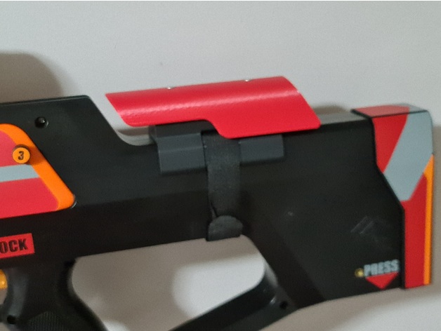

@Invader79 I think you will like the parts @Foamsnake designed for the swift and this cheek rest.
